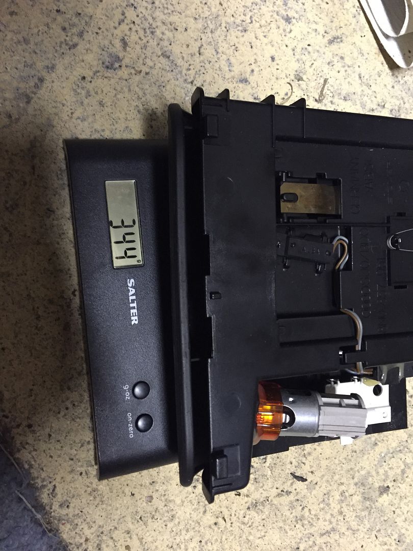

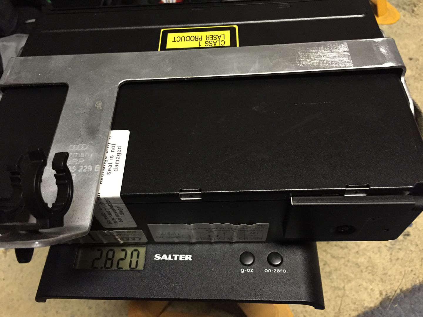

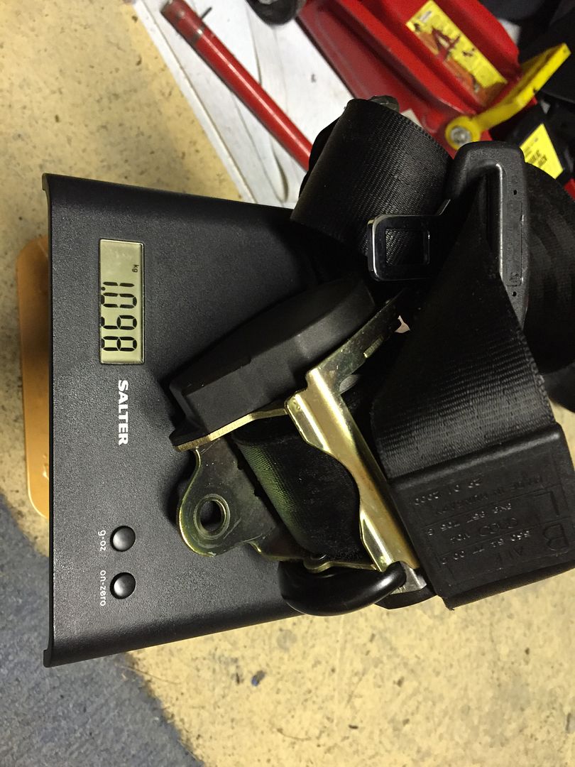

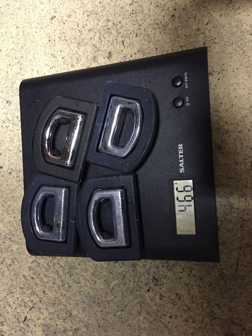

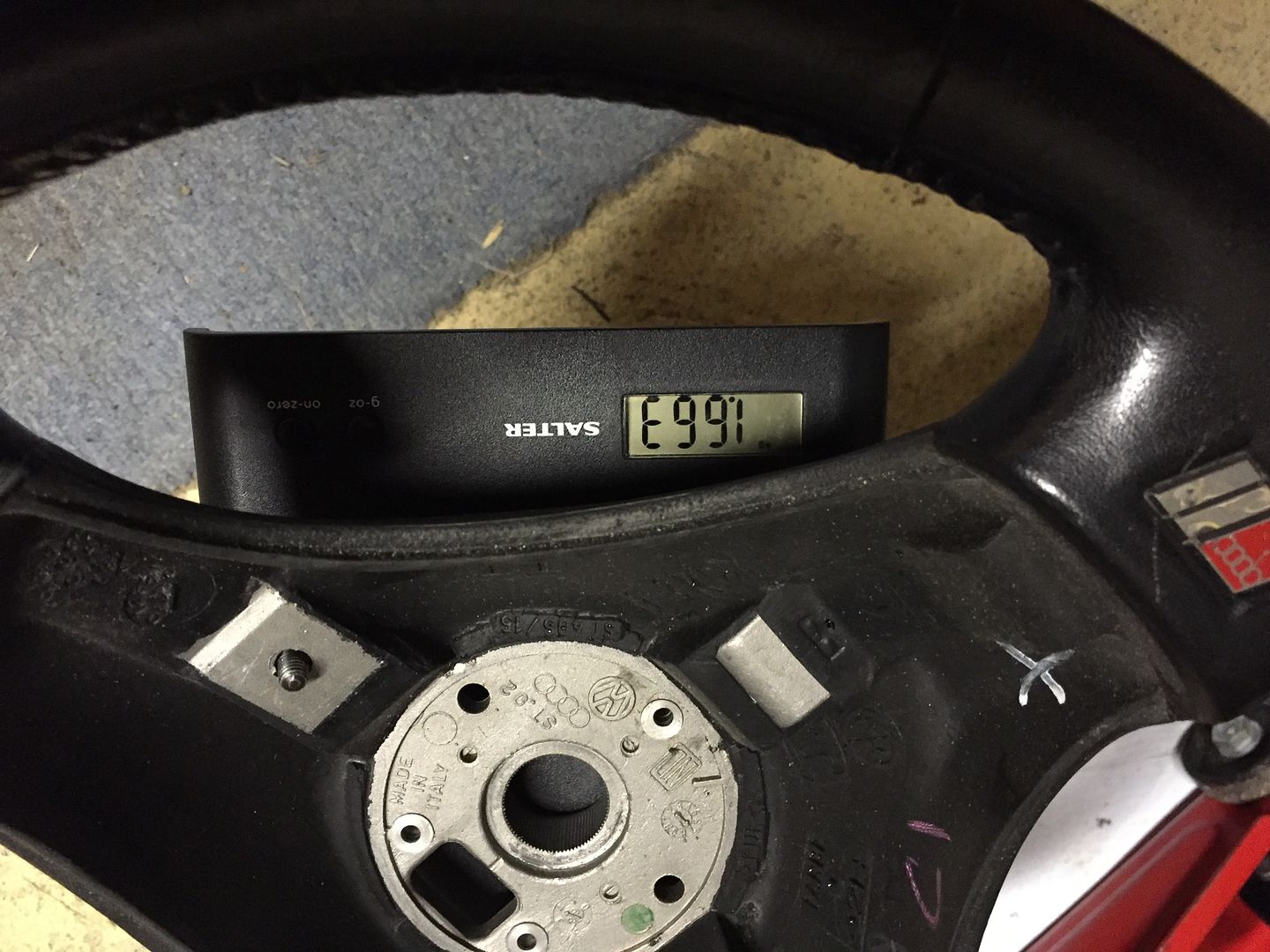

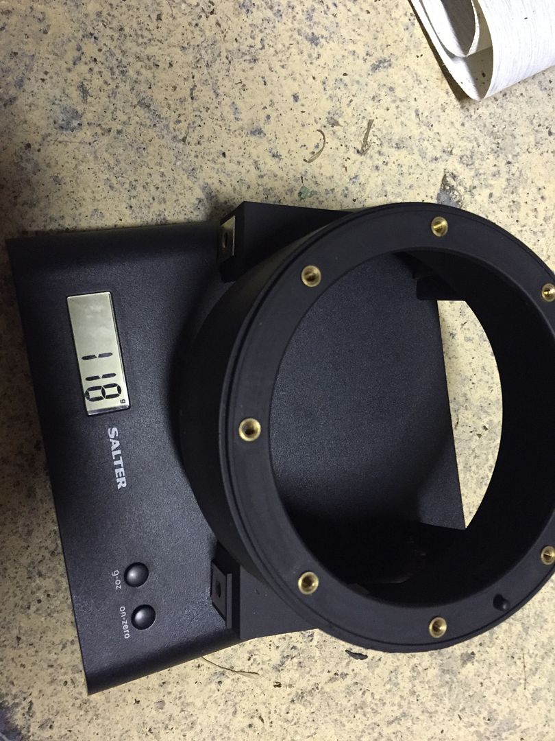

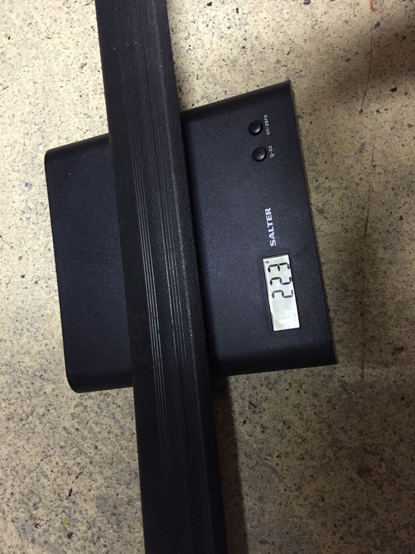

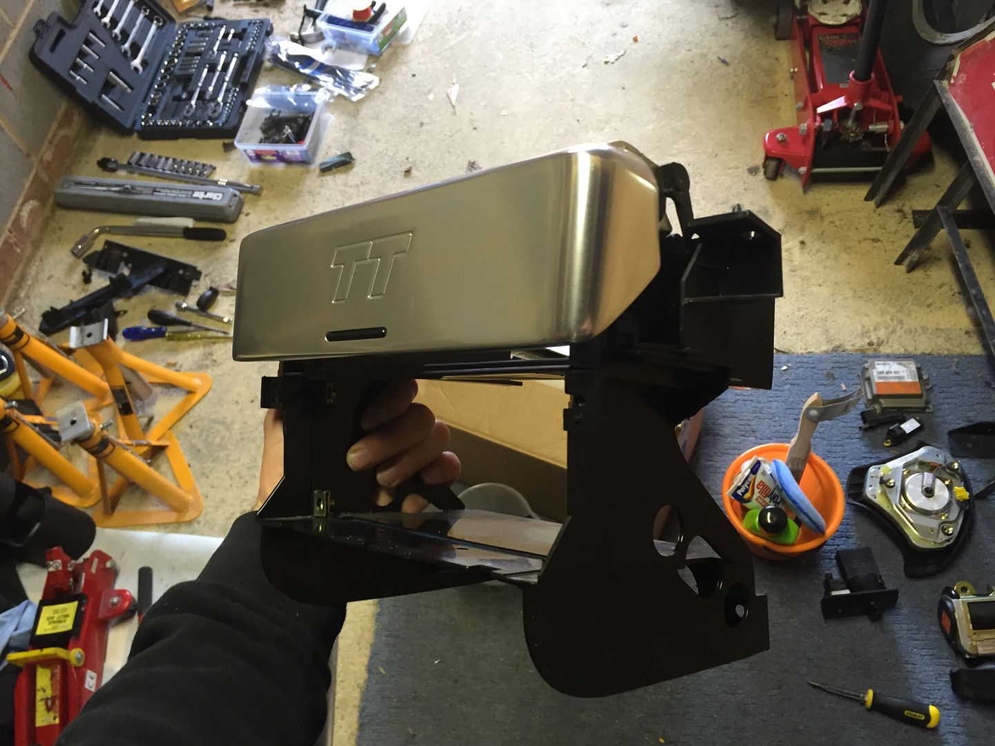

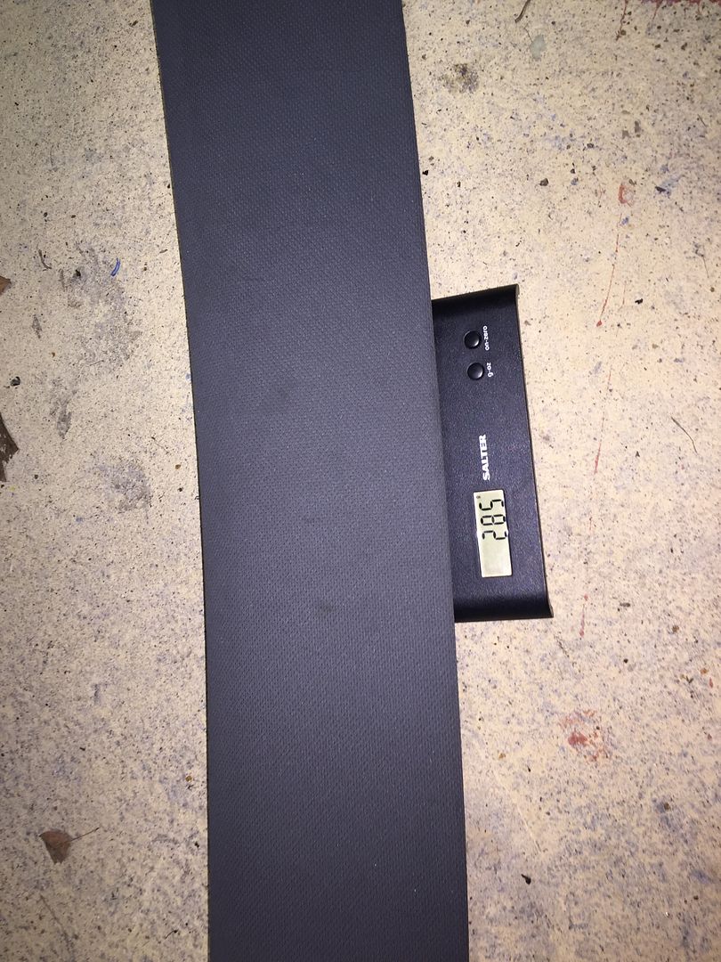

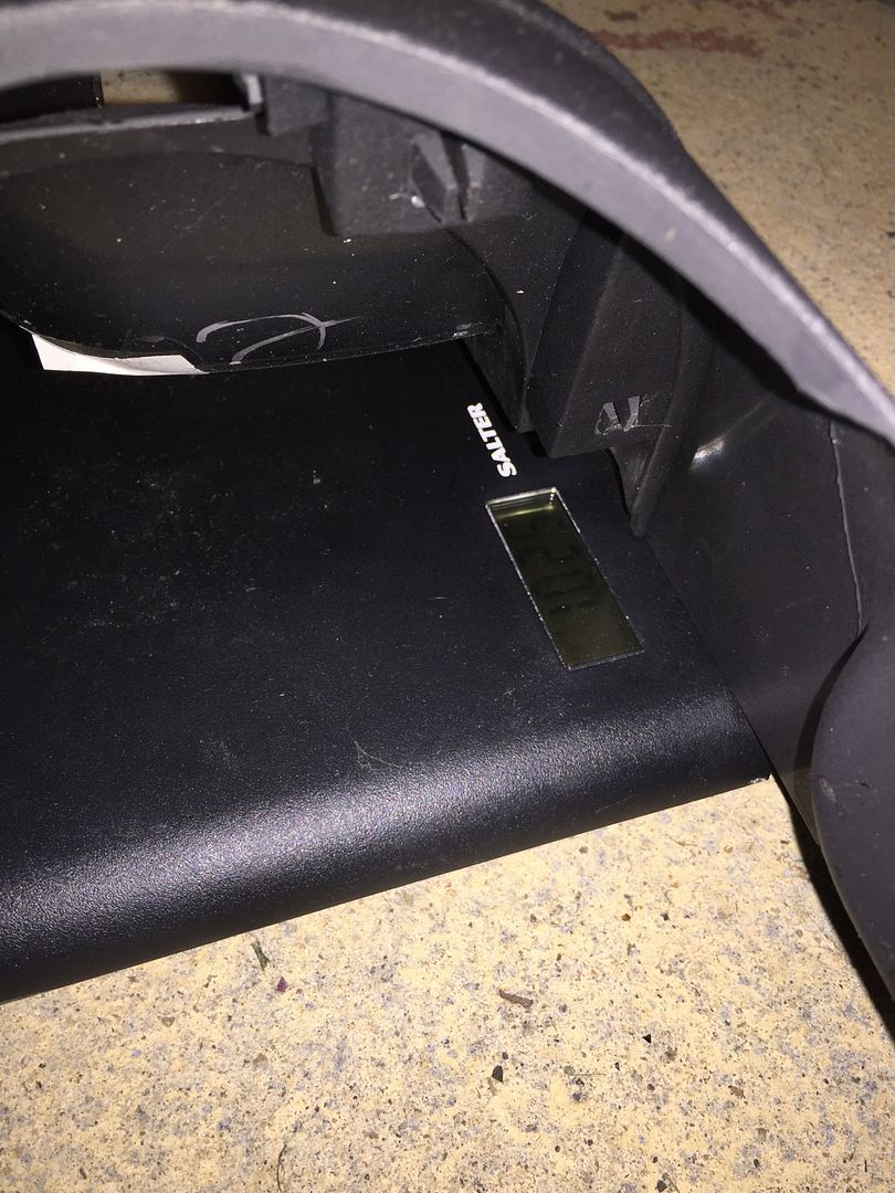

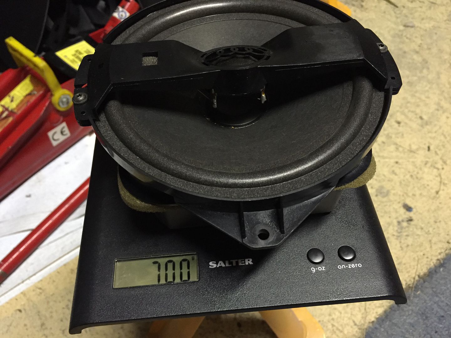

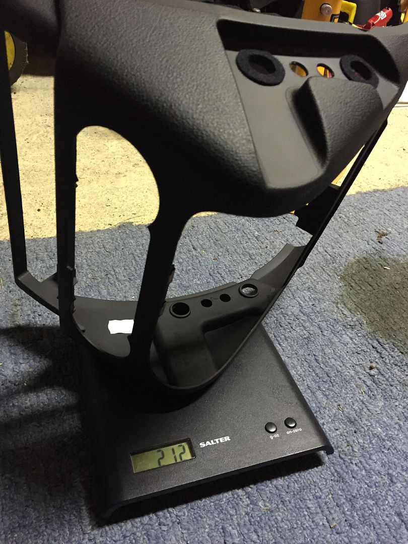

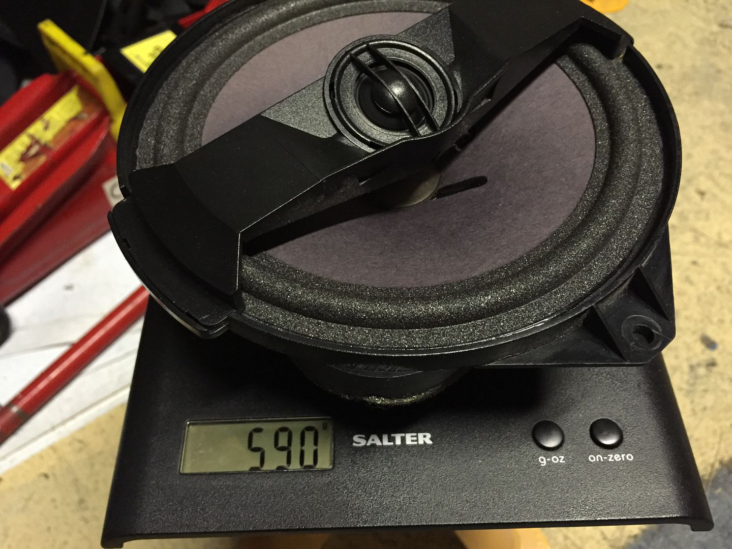

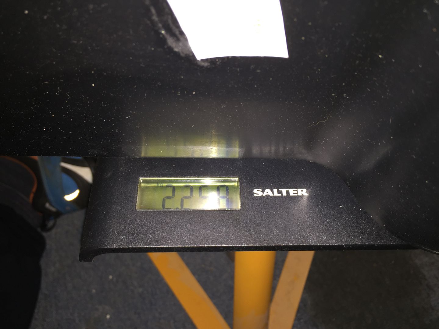

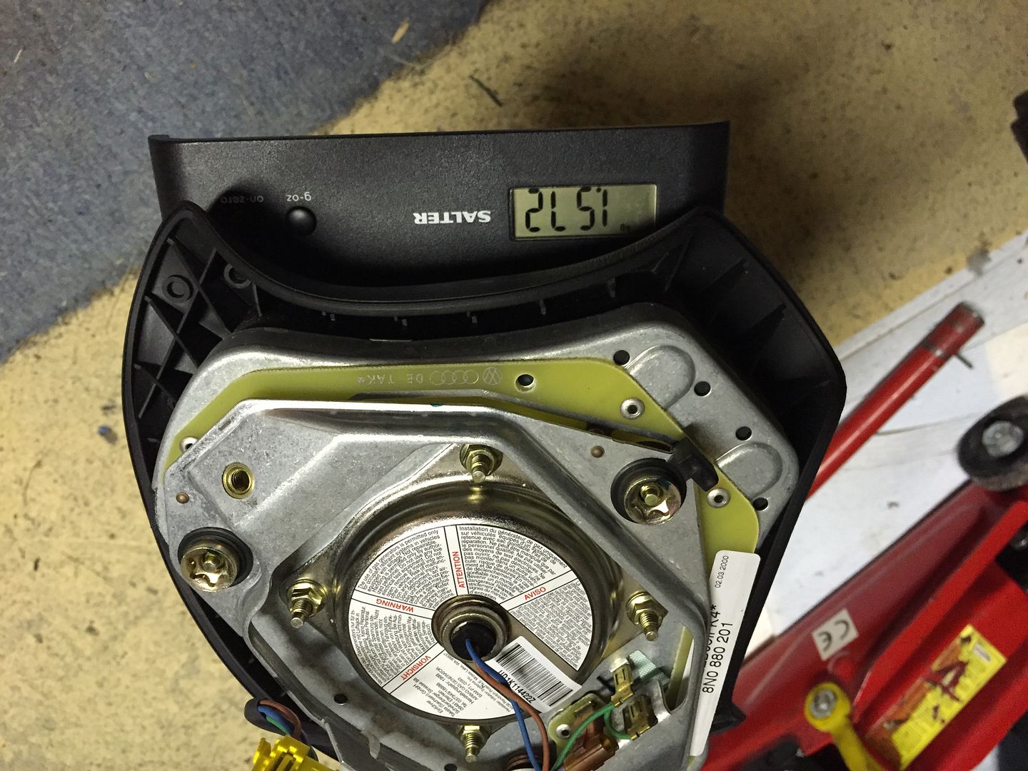

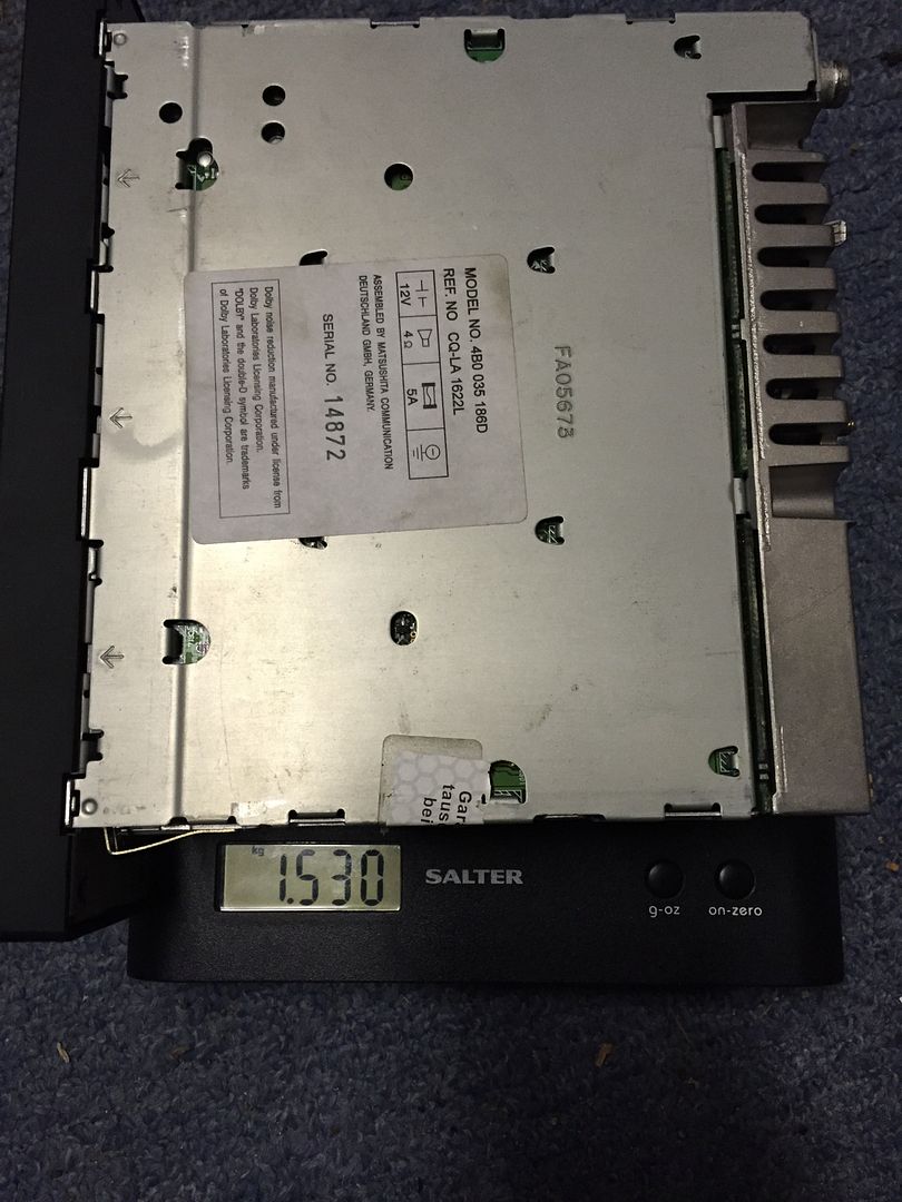

You ready...
Cd Changer inc. metal bracket - 2.82kg
Drivers side speaker - 0.59kg
Passenger side speaker with crossover thing - 0.70kg
Steering wheel - 1.66kg
Steering Wheel Airbag - 1.57kg
Concert Stereo - 1.53kg
Ashtray/Drawer - 0.34kg
Seatbelt - 1.09kg
Gearstick plastic bracket - 0.12kg
Luggage net buckles - 0.47kg
1no. Door Cill plastic trim - 0.22kg
Tunnel plastic/hidden tray - 1.03kg
Ceiling rear trim - 0.29kg
Climate control surround - 0.21kg
Glovebox - 2.26kg
