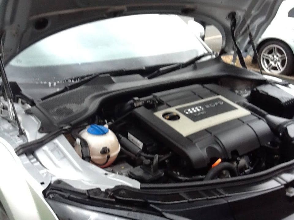

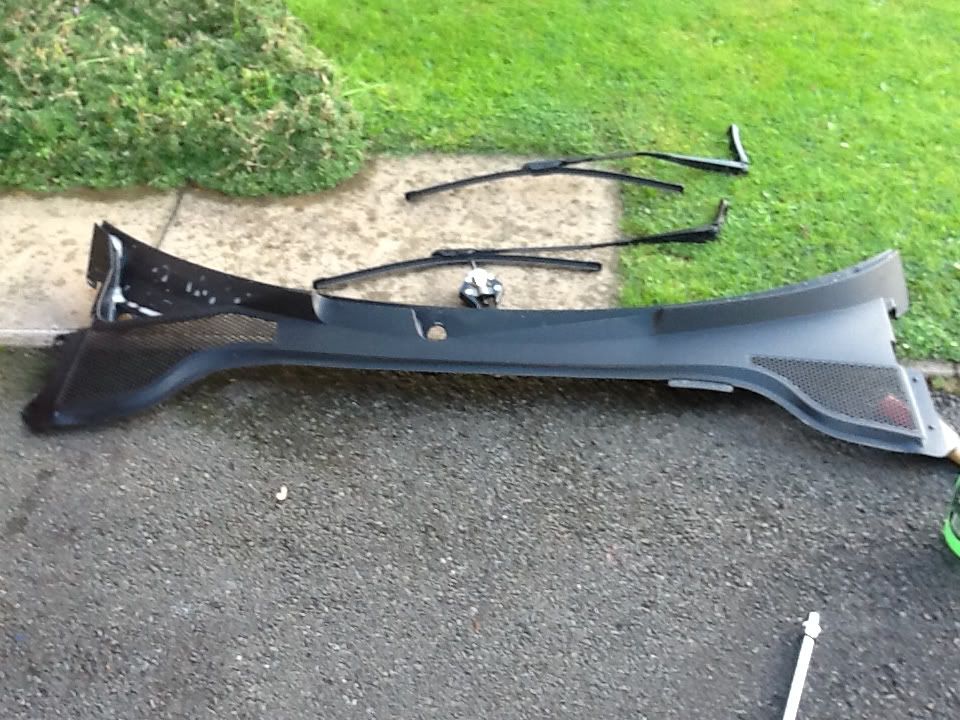

First off remove the wiper arms (I used a wiper arm removel tool off eBay cost £10.00
Wiper arms with removel tool
Remover two screw on drivers side of the black cover
Using soapy water wet the edge of the cover under the windscreen and pul up

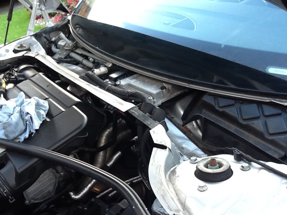

Now you can see where the new strut brace will fit

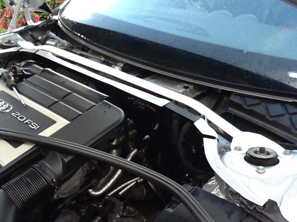

New strut brace bolted in place ( Please watch the cable from the ecu unit )

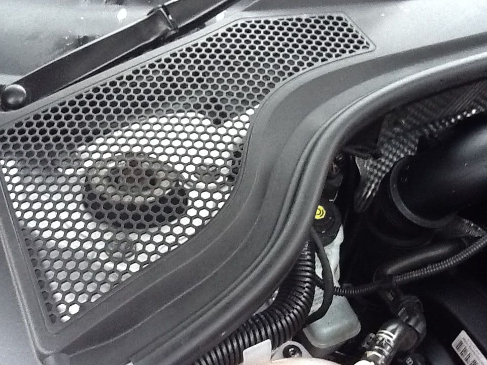

Cover back on plus wiper arms fitted
Not a lot to see after fitting
Now fitted and done 70 miles with it on the front it feels a little stiffer around corners so for the £54 pounds I paid for it
I Am very pleased with it
