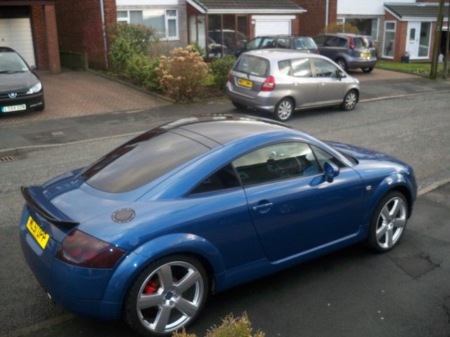

Ive been on here a while now, owned the TT just over a year and got to know a fair few people. Ive have had a few people ask if i had a progress thread to which i had to reply not really :roll: . So decide to do one as my last 1 on my cliosport was quite successful. Bit about me, i was 20 (now 21) when i got the TT having owned a a clio 1.2 from passing at 17 which was turned into a cliosport and i even put a 2.0l engine which didnt go down to well. So i cut my losses and got rid for the TT i have today.
This is how i got her. Had a few mods already, like 'miltek' exhuaust, autobahn88 tip, Rs6 Alloys, Rear headlight tints, Front headlight tints, black vinyl wrapped roof/fuel cap, Lcr splitter, turbo badge instead of audi rings, red calipers, V6 spoiler, V6 rear valance, 3 bar grille.

Great write up and good to see someone with a bit of passion for their car.
My head keeps shaking from side to side whenever I see your flocking think it's just an inbuilt reaction.
Enjoy mate enjoy, good work. [smiley=thumbsup.gif]
5,856 Posts
Love your car, looks spot on to me. Nice way to keep together all the mods you have done. We should have a build thread sub category where everyone can post threads like these. I can imagine after a few more mods, I'll start loosing track of what I have and haven't done and I haven't even done that much to mine!
