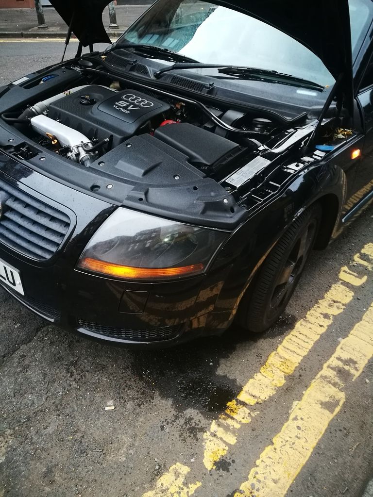

Clutch goes straight to the floor and dosent return.
Clutch(Brake)Fluid seeps down over starter motor onto grounds below battery area.

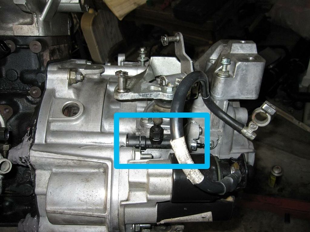

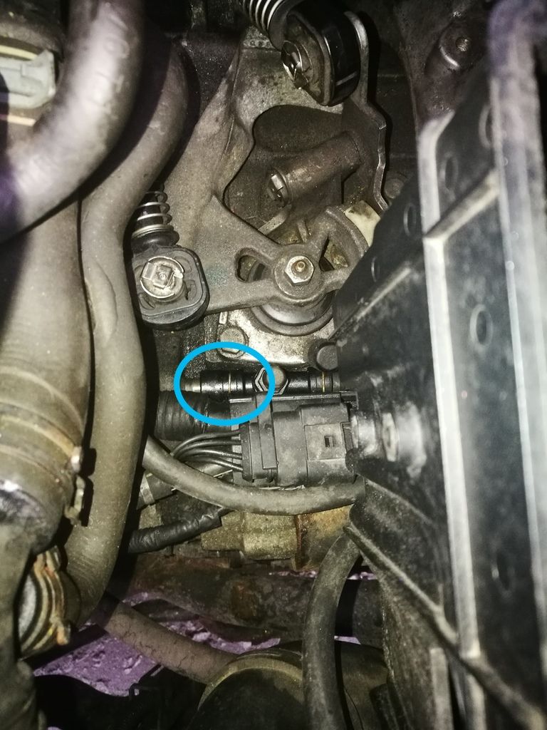

If you have fluid on the ground you will have lost some from the brake reservoir as the clutch feeds off the top of this and the brakes off the bottom. Open up the reservoir and fill with new fluid. If you have someone with you get them to pump the clutch manually while you observe the bleed nipple from above in the engine bay. This can be located by looking down the left hand side of the battery.

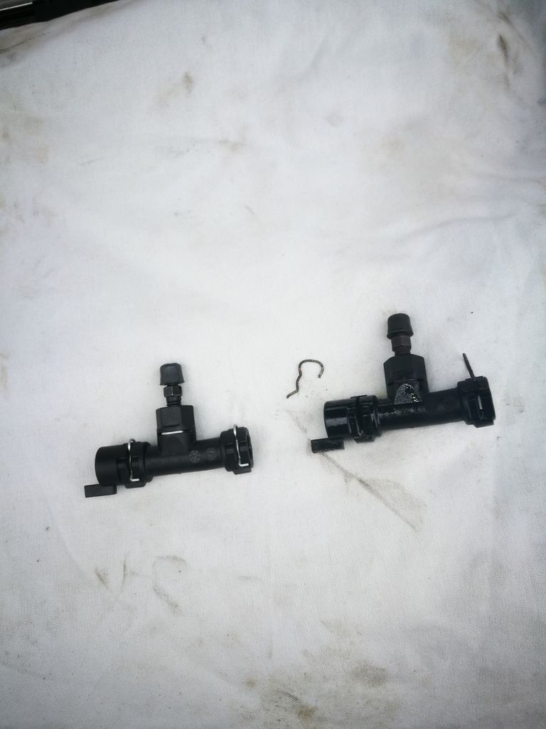

If your on your own either position your phone to record a video looking down or wait until there is no more dripping and then pump the clutch by the time you run round you should see the fresh fluid dripping down. If you can observe from above and you see fluid coming out of either side of the bleed nipple then this may be a strong indicator to a failed clip on the nipple. In my case the clip had rusted through and a part broke off so there was not tension in the connector joint so fluid was escaping out the circled.

once both clips are up remove the clutch pipe on the right and then force the bleed valve out the housing by pulling on the right hand side of the valve and pushing on the stem of the nipple from the left hand side. it should just pop out. Below is a comparison of my new and old showing the failure.
