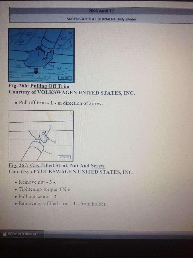

Once you remove clips, you will be able to pull the seat up in order to remove both bolts which hold on the gas strut.
6) remove gas strut bolts and unhook the operating cable.
