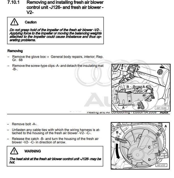

Remove your blower fan and check for binding / interference.. If binding, lubricant will likely provide a temporary solution but will probably fail again (buying you time to sorce a replacement).
To access the blower simply remove your glove compartment and the blower comes out with one screw.
Do not insert your keys in the ignition while doing this or you'll trigger an airbag error which requires a VAG-diag tool to clear.
Cut from Workshop Manual "Heating and Air Conditioning". Download links can be found in the forum Knowledge Base.
