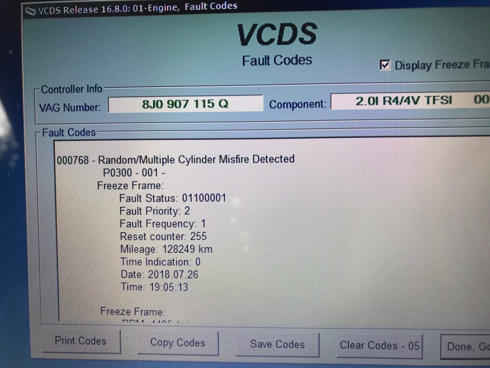

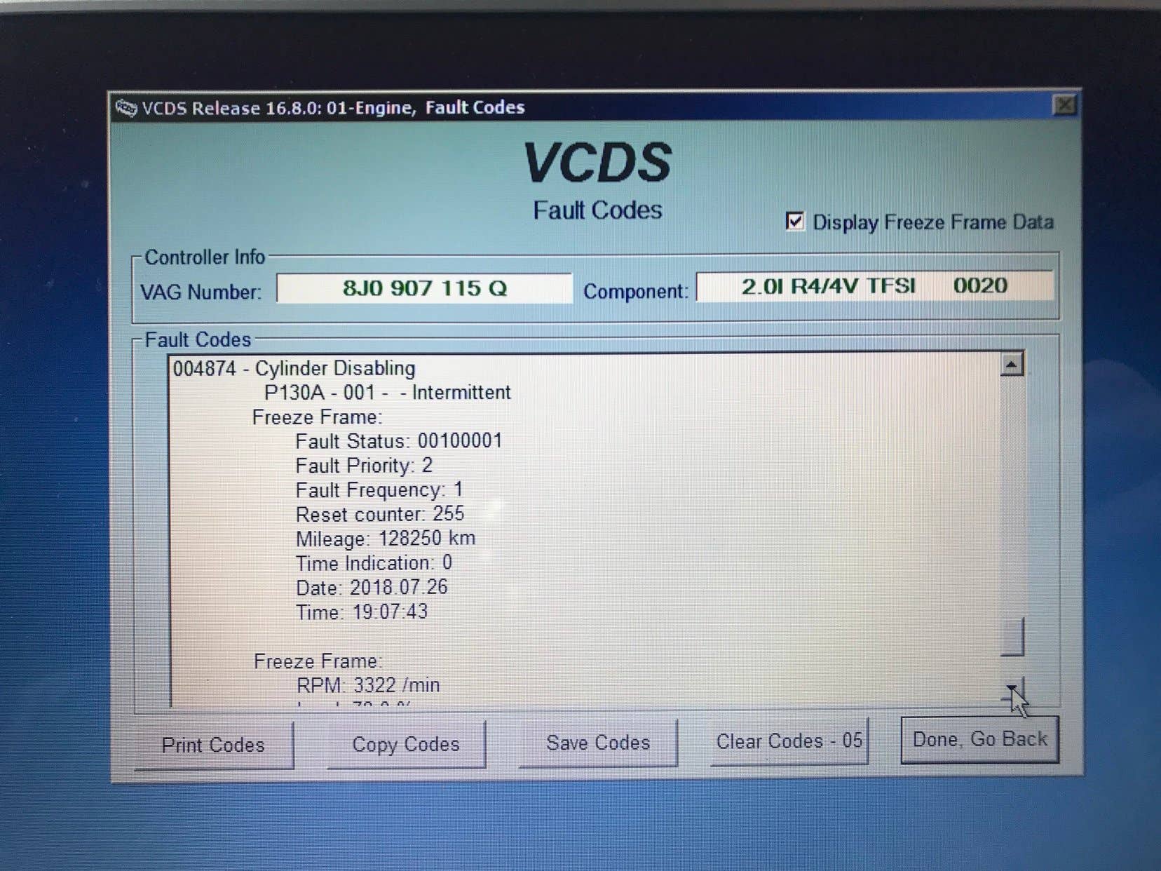

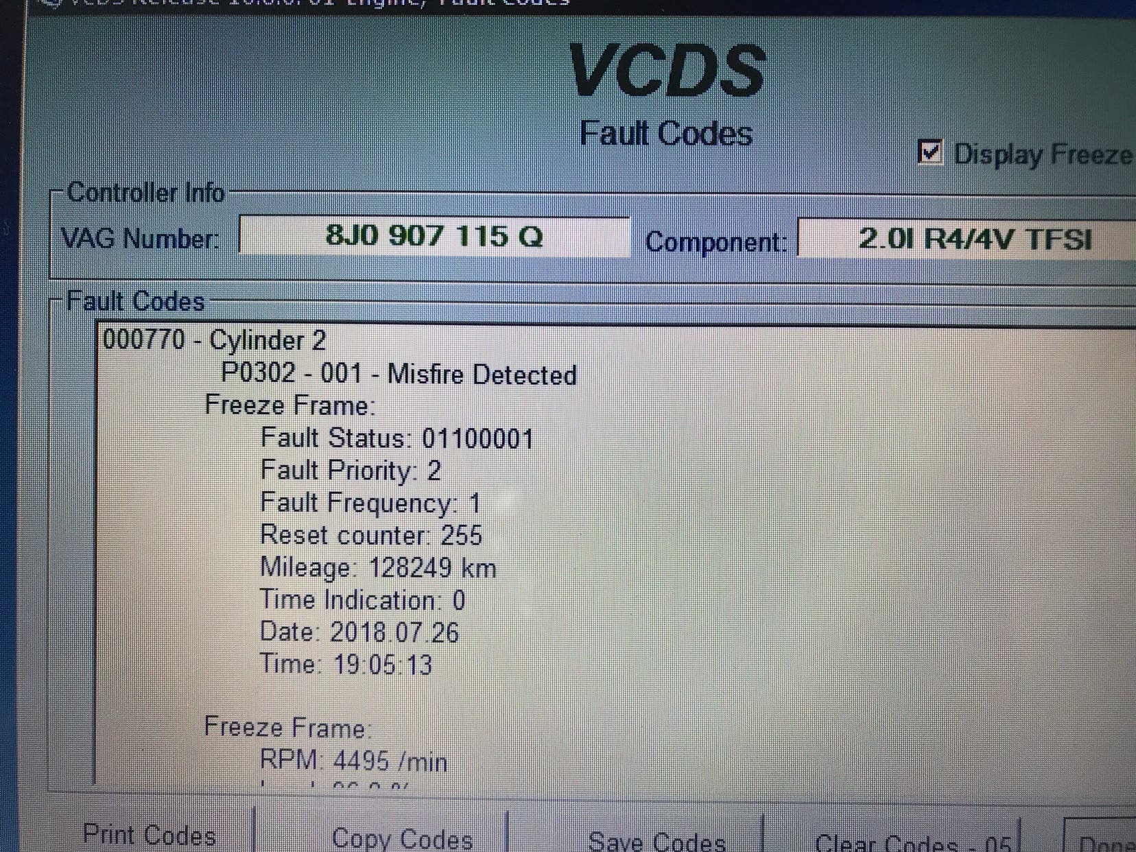

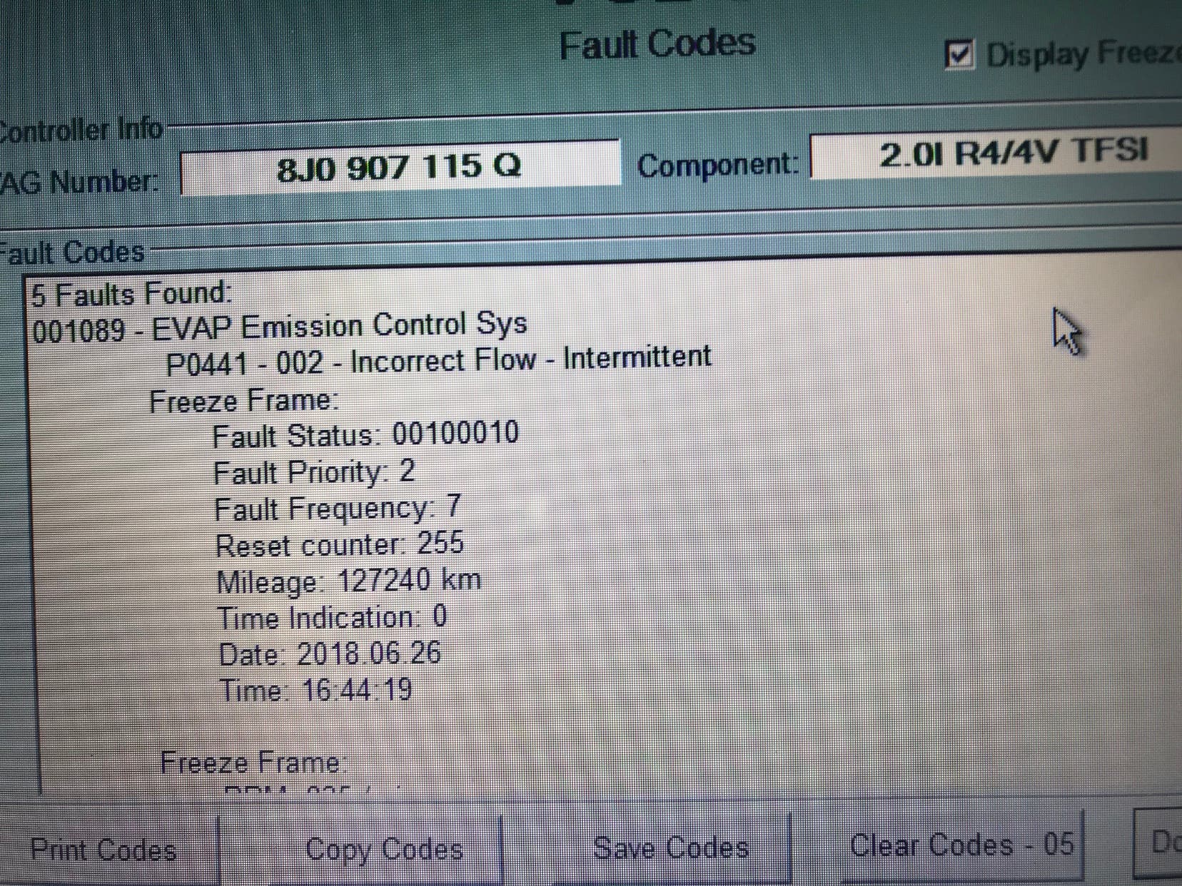

Took the car out yesterday and the car is idling perfect t but when the engine is under load it misfires really badly, checked with vagcom it's misfiring on cylinder 2, tried swapping the coils and plugs and it's still only cylinder 2 I have the following codes....
Could this be a injector fault ?
If you swap the plugs and coils around and the problem remains on the same cylinder, suggests a failed injector.
