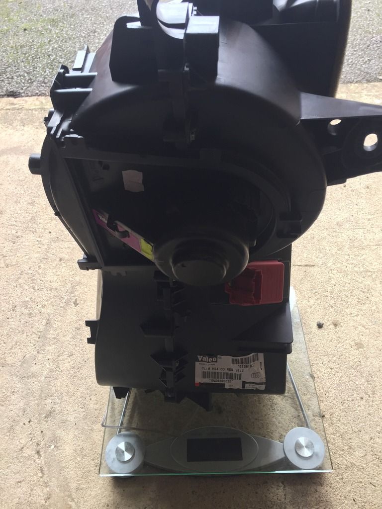

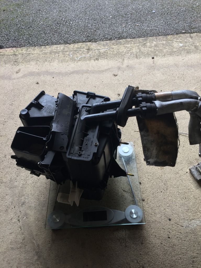

Finally removed that pesky heater matrix and was presently surprised...
3.0kg and 4.7kg = 7.7kg!
My replacement is just under 1.2kg so a lovely nett saving of 6.5kg!! I was only expecting 5kg so I'm happy with that!

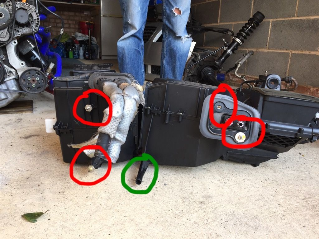

What parts would be difficult Nick? My a/c manifold is history, so it looks like...drain the coolant, disconnect the two water pipes, undo 4 studs and the rest is from the inside. As the thing is scrap I could just cut off the studs from inside if I can't get to them easily...maybe?
VT

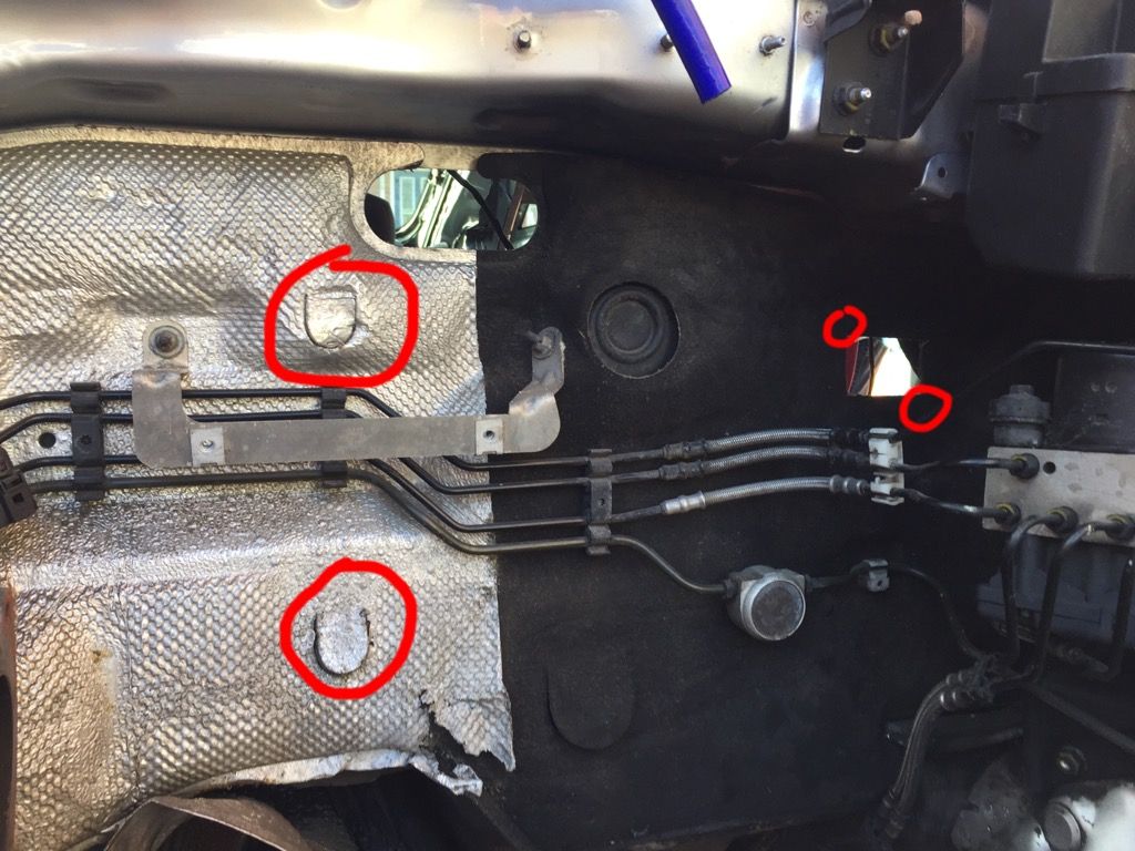

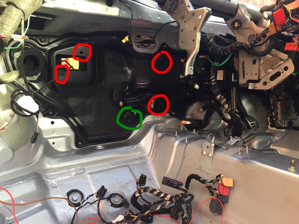

Yeah it's the studs from the engine bay that are a nightmare, you have to contort even with the engine out as they are behind some heat shield/insulation. It's certainly possible that you could cut it off from the cabin side I guess, although again it's so tight that I just couldn't see even where the studs were when I was looking.
Discussion starter · #59 ·
Nick, when you get a minute could you take a photo from inside the engine bay identifying where the studs come through and maybe the back of the complete unit showing the studs themselves please? Thanks.
VT
Okay, so the red circles are where you'll find 10mm bolts 4nr in total, the green circle is where there is a plastic leg that just pushes into a big rubber grommet...
Hope this helps!!! 8)
