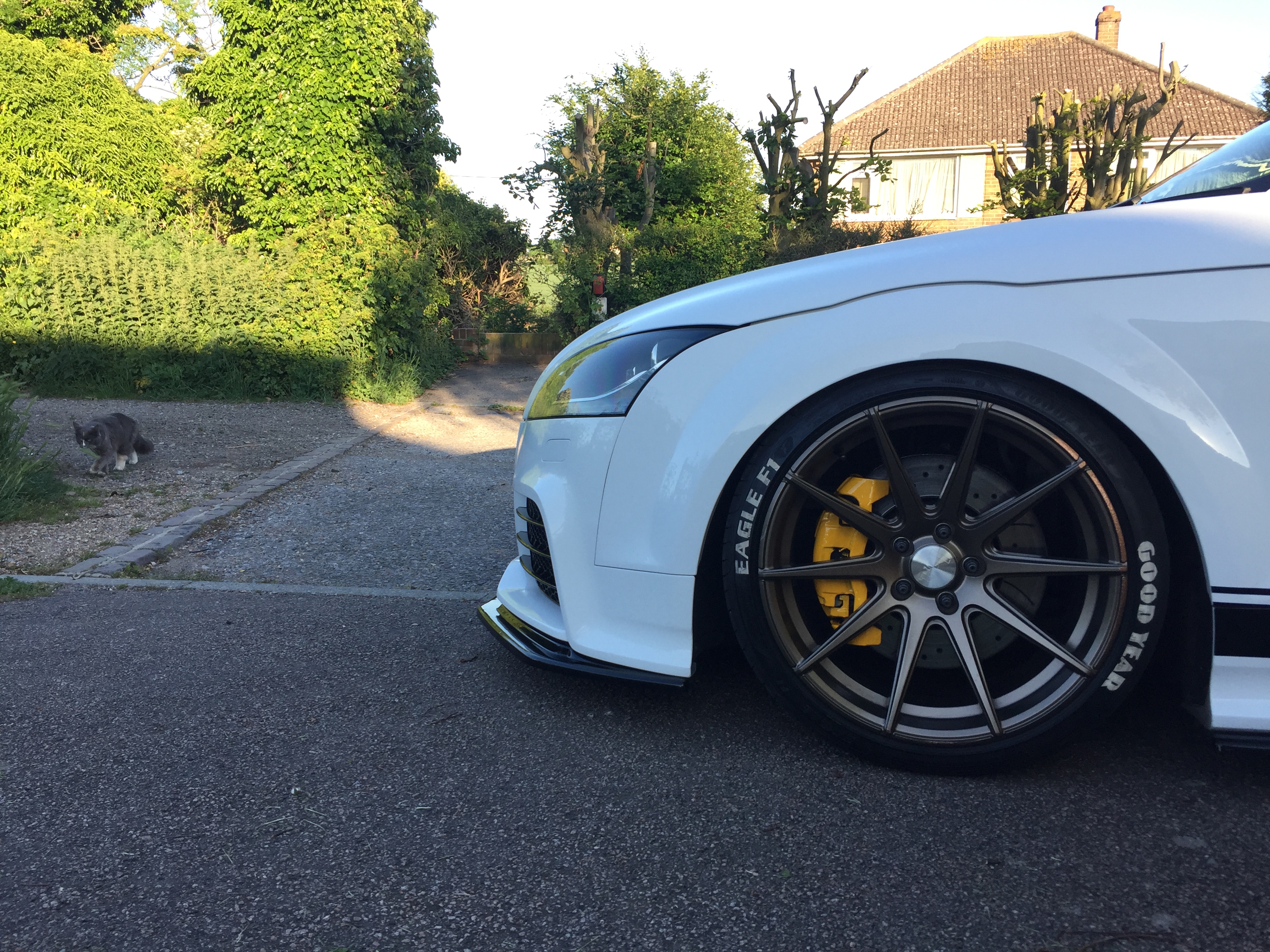

I liked this look, but they were incredibly small, had looked into actual tyre letting but so far the cheapest I have found was £100+ and I think that's far too much for some white on tyres. So again turned to my school friend and he made me some templates and was much more impressed with this! See how well the tyre pen lasts now its on the actual sidewall rather than in the textured lettering.
So this leads pretty much where we are at. Other than the last thing I have done...
Taken from the polo, I wanted yellow brakes again for so long but I thought this would never go with the finish of my wheels. I should of got the paint and bushes out earlier! I do wish I had the money to drop on some real yellow brakes but I can't justify spending the money on a set of 4-6-8 pots for the actual performance gains I'd have. So couple of hours and a brush will do for me! Have a picture of our naughty little cat joining in for good measure.
