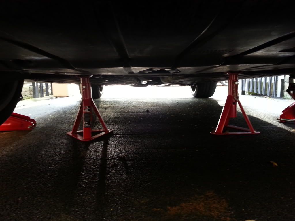

In order to get to the oil filter and drain plug, your first challenge is to get the under body panel off and out of the way. Depending on your year and model, you may have either a one piece or two piece under body insulation panel. The one piece panel is all plastic, the two piece has a plastic front and aluminum rear panel.
www.ttforum.co.uk
To get the bolts off, you'll need two different Torx bits and one Tripple Square bit;
• T-25 (blue) goes into clip-nuts
• T-30 (red) goes into the frame
• Triple Square 8 (green) only one into the frame.
Don't be surprised to find there may be some missing or damaged bolts and/or clip-nuts. It's always a good idea to have a few spares just in case. Note - the image below are under body panels and screw assortment from my 3.2 VR6 Roadster.
