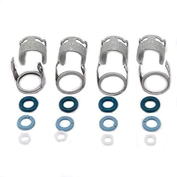

So have I bought (another) eBay dud or have I got a strange set of injectors? Also I broke one of the plastic mounting clips (it fits over the injector and holds the metal spacer in place, but I can't find any injector kits that have a piece that looks like mine. The nearest has three legs but mine only has two.

Injector seal kits you are looking for should be 06D998907--each will include all parts to seal one injector (so you need 4 total). Now these you can typically use the cheap/fake ones of Amazon, eBay, etc. and they are fine. I've used such ones several times now with no issues. I'm actually just re-sealing my EA837 injectors right now (electrical tape on them now to compress) and using Amazon-sourced seals. Crossing my fingers but yeah other similar ones worked out fine before so I'm not too worried about it.

Nearly all the sets that come up for 06D998907 are definitely wrong. I have found one that might be right using 06D998907G
Looks much more like mine but the clip looks to be metal rather than the plastic one I have.
Injector part number is usually on the connector body--the part where it plugs in. Maybe yours has faded/worn off...possibly never there to begin with...
The metal clips were the updated ones I believe; they do the same job presuming that's what yours look like. Odd you can't find seal sets over there. There's lots of these sets on Amazon, etc. over here, back when I did the carbon clean on mine this was the exact set I got I think:
Lots of other listings for same ones too. Maybe that doesn't help you if it doesn't ship over there or if shipping is pricey though.
