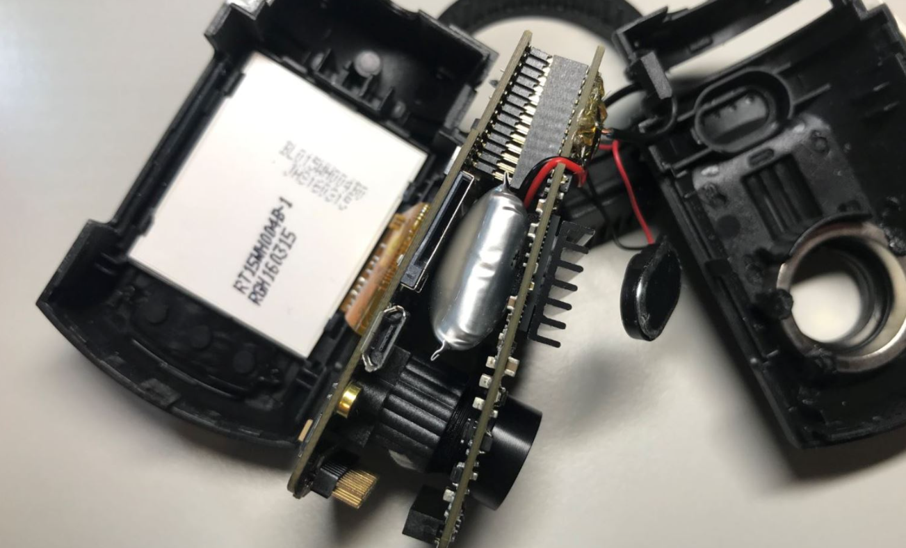

I used to have Mini0806 dashcam which fitted quite well directly behind the mirror. Put placing it on the opposite side as the driver, it was completely hidding from the drivers view and was very difficult to see from outside.
However this dashcam uses a Lithium Polymer (LiPo) battery which failed after about four years. I even replaced it but the replacement battery didn't do so well either. As you can see in the image below, the battery actually swells up and can damage the PC board. So do some research on the best battery/capacitor recommendations.
For anyone else considering one, the use of a Piggy Back fuse holder makes hard-wire installation pretty simple. Just be sure you install it the right way around -
