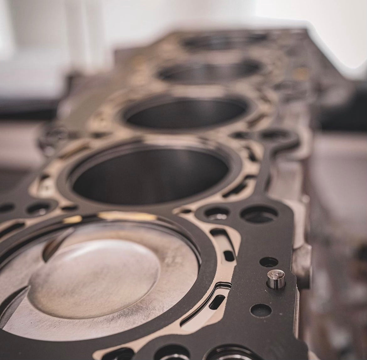

Engine pic of the motor, (which needs a damn good clean IMO);

Q1: What would cause the block to need replacing?
I'm assuming overheating from a previous poor tune, ergo the Ali block cracked?
Q2: Are the OEM pistons deemed good enough for 500-600Bhp builds?
Q3: Are aftermarket pistons stronger & more durable and therefore a necessary requirement for a circa 600Bhp plus tune?
Q4: Is 576Bhp acheivable with the stock tubby & exhaust or not?
Q5: Surely to achieve maximum power & torque, reduce lag, lower heat, remove factory restrictions and create a powerful fun safe car to drive, all areas of modification's should be explored, budget allowing of course, such as downpipe, intercooler, induction, cooling etc?
Obviously Infinit have a solid reputation and know there stuff for-sure, I am not here to disrespect them at all, they are without doubt experts in their field and they know heaps more than lil ole me for-sure. But to me things do not add up and it seems me that the engine in this motor is being pushed to its limits, (Or close to the edge) without certain upgrades being fitted? Which would support the mods and help achieve max power at safer cooler running.
Maybe the car was a work_ in_progress for the old owner, but then why spend £10K plus and not finish the job? They may have just run out of funds or moved on to something else - who knows but something is awry! Or perhaps it's my tin foil hat is causing me to miss something here?
Perhaps some more learned & knowledgeable members can shed some light on this topic?
TIA
1) the most common (and probable) reason for replacing the engine block is a conrod breakage that cracked the block...
2) yes
3) aftermatket pistons (JE and the like) are surely stronger than OEM ones but I believe they're not a must for 600 bhp... this said, once you decide to rebuild an engine to get maxiumum power&reliability, sounds not a big bargain saving money on core parts like pistons ...
4) stock turbo should be still ok for that amount of power, but again, is a matter of long-term reliability (also depending how the engine is used)
5) for a full DAZA/DNWA engine rebuilt using top quality parts, minimum budget is 20.000 eur
