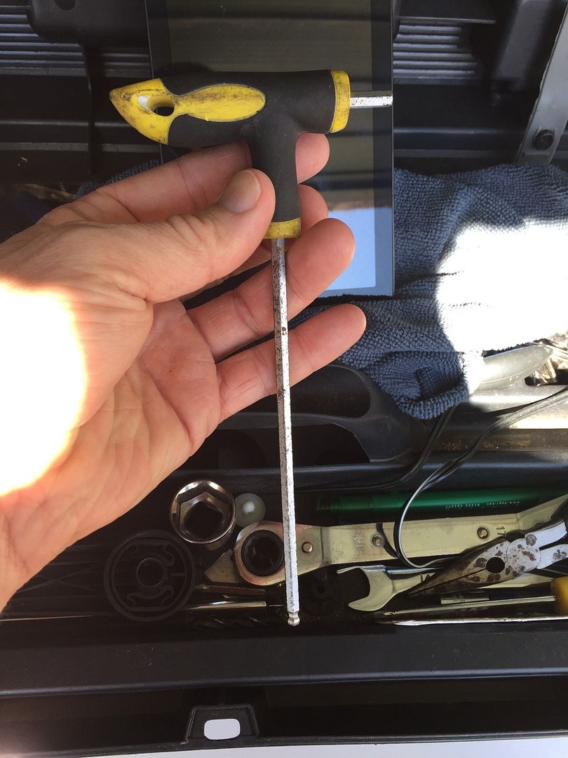

2. The throttle body itself is attached by 4 hex bolts. I found that a 5mm hex bit on a long screwdriver (like the one that I bought especially) worked best because I couldn't access the very bottom bolt using an allen key, not even a long one

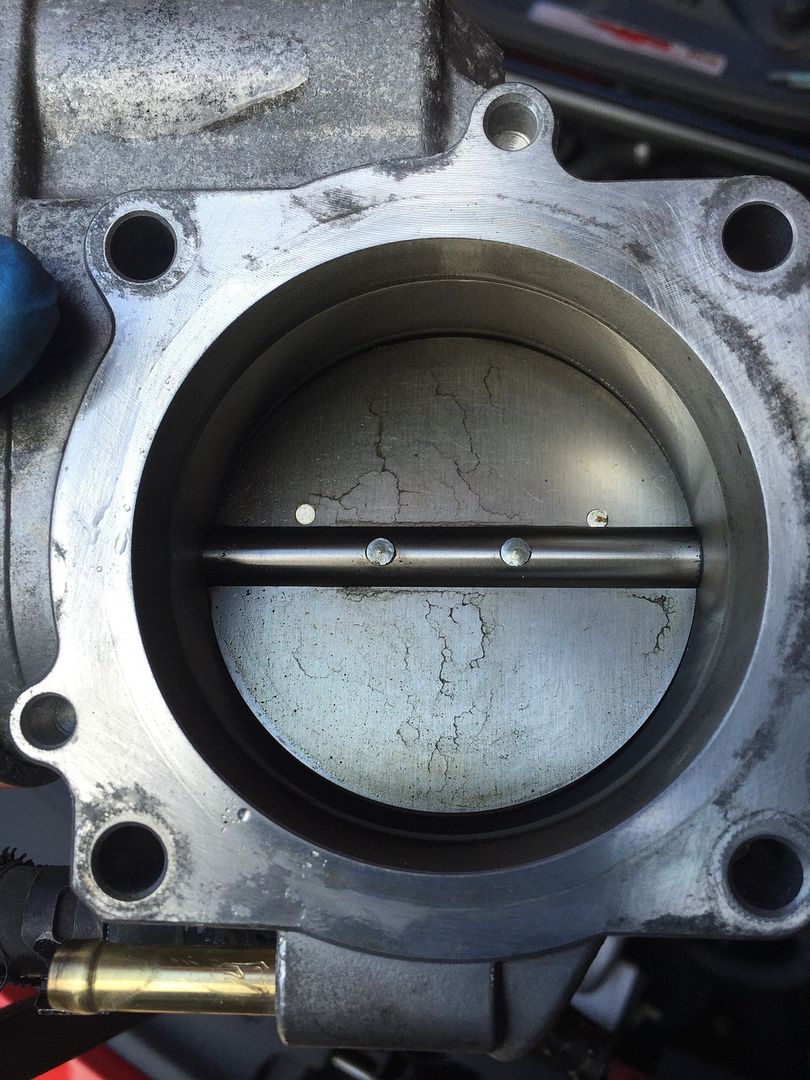

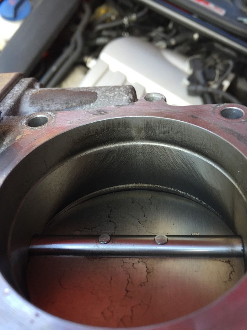

As you can see, my throttle body was pretty gunked up
It's very important to note that during the cleaning process you should keep the cleaning solution away from the electronics of the throttle body, or you may damage it. To that end, always keep the electronics parts at the top so that the cleaning solution naturally drains downwards and away from the components. In the photo below, the electronics are housed inside the black part of the throttle body.
Also note that the throttle butterfly (the round bit in the middle) is driven by a sensitive stepper motor, so do not use any force on the butterfly or try to open it as otherwise damage may result.
Holding the throttle body in one hand with the electronics side upwards, carefully spray the carb cleaner into and around the throttle butterfly. Wait for a few secs then gently use the clean cloth to wipe away the majority of the gunk. Now gently use the cotton buds to wipe around the circumference of the throttle butterfly.
Now take a clean piece of paper and tear off a small strip. You can then feed the paper through the gap around the top and bottom of the throttle butterfly to dislodge the gunk trapped where we can't get to. Be very careful not to get too close to the hinges of the throttle butterfly or the paper will become stuck in there! And make sure to only use the cut edge of the paper to do the actual cleaning as the torn edge will be ineffective and is likely to get stuck in there. With the gunk dislodged, use a cotton bud soaked in carb cleaner to wipe around the edge and clear it up.
Repeat this process for both sides of the throttle body, then repeat the above steps until you can't get any more gunk out.
Once you're satisfied it's all clean, and still holding the electronics upright, give a final spray around with carb cleaner, let it drain off then dry off with the cloth and cotton buds. Put the whole throttle body down with the electronics upright and leave it to dry off for a while.
The finished result should look something like this
