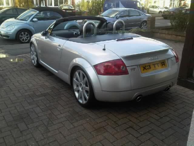

Since having car lowered as im slowing down or low speed get a droaning noise???? i know people say its coz i need tie bars but im not 100% may be bearing ? .....
Cheers mate im away this weekend but will asap.... whwere some pics of ya car ???? thought u would of posted them hehe
There is another issue with the rear diff where the tyres develop regular flat spots and end up looking like 50p pieces. This can come about from lowering without proper correction of camber and toe - the tyres scrub and slip with oscillating movement coupled through the rear differential. This can be accompanied by a humming noise. See here:

thanks but nly had lowered about 3 weeks surely not already ?

I know mate.. the TT is just one of those cars where if u do one mod, another mod may be needed to keep it all sweet!
Its worth it in the end though :)
Suraj, has your car been ok since you lowered it? Make sure you keep checking your tyre wear regularly.
Interestingly, mine seems lower now that I'm rolling on 19's as opposed to my old 18's.

Hey Naresh..
Yes I have been checking - and at first it was ok, but now i think i can see the camber is slightly out.. you can give me your thoughts at the ace ;)
Yep, your 19's will defo make it look lower as the arches will be practically filled!
