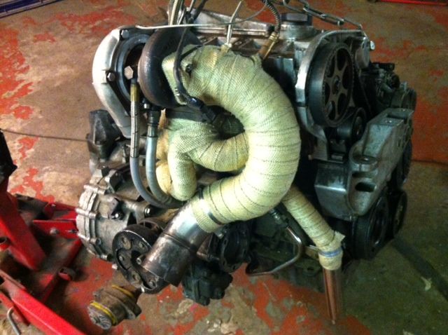

im not a big poster but heres a pic of engine build for those who dont know this car.

What exhaust manifold are you using?
I was going to say that looks like a Backdraft kit but they didn't do an external gate, makes sense if it's been modified though.

It looks so different to this from backdraft?
Am I missing something?
I'm looking at their manifolds but to me This pic looks like it's all mounted the wrong way round.
Surely the down pipe would be too close to the belt?
