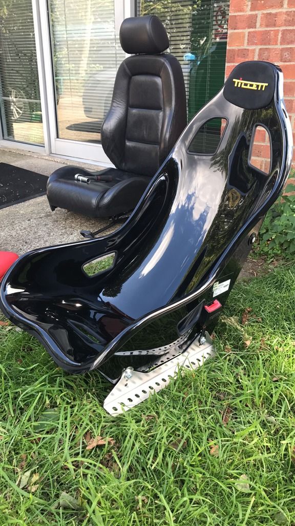

Tillett B6F seat

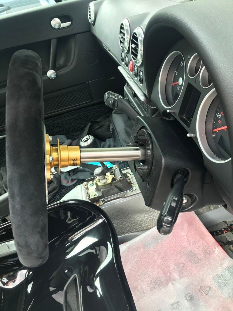

Steering wheel
Quick release boss

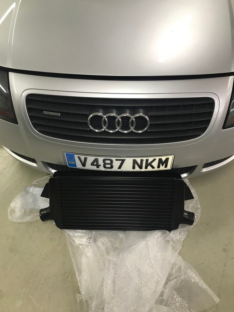

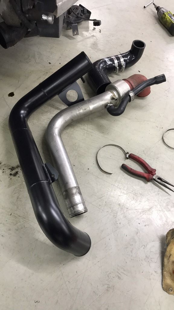

Whilst I was not into the car the parts i had ordered turned up then I found out the ic kit didn't fit my car for some reason so a deal was struck so I altered the pipe work so it fitted. I did this in between work when i could be bothered with it. I was annoyed as it turned into more custom work. [smiley=bigcry.gif]

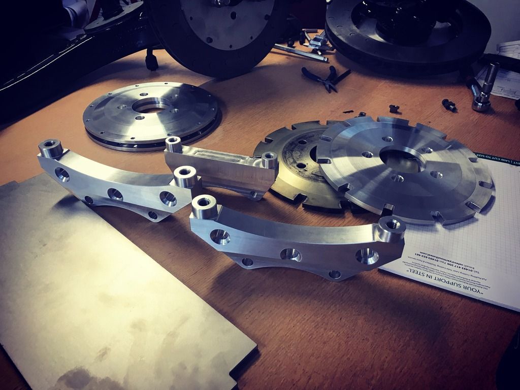

I also bought a alcon big brake kit off a time attack car that my mate supports so more custom work to make it fit, wasn't the end of the world as just needed some bells and brackets to be machined. Oh and it needed a hydraulic handbrake as the rears have no mechanical handbrake.

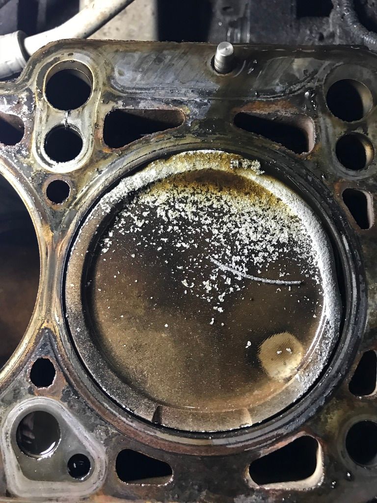

New engine ordered and my mate fitted it for me on the dyno again and still the same it had all different sensors and the afm was a oem one from the secondhand engine. after hours of work, I bought yet another afm from vw. All worked and was fine. I had a total of 4 afm's and only one was good. I found out the afm had been changed just before I bought the car and it must of been one meant for another 1.8t engine, during all this I learnt a lot of motor factors list the wrong part from the apx engine.

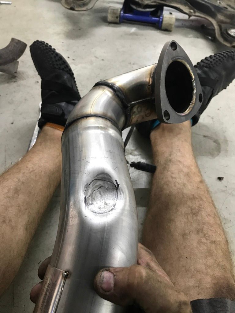

Down pipe was touching the driveshaft coupling

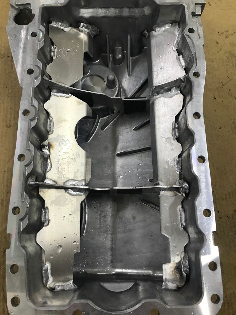

Forge sent baffled pan with hardly any welds and one had already cracked

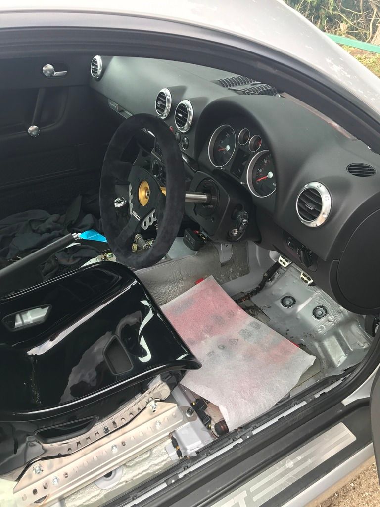

Cage install

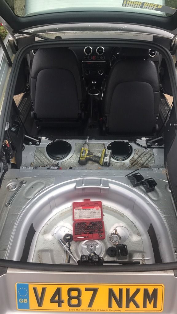

Your biggest enemy here will be weight, there's so much weight to remove from these cars, head to the motorsport section and check out this thread;
http://www.ttforum.co.uk/forum/viewtopic.php?f=250&t=1140105
Stupid things like a 15kg NVH damper behind the rear bumper, 10kg of sound deadening that can be removed in the cabin, amongst many other items.
HI, Looking good. I have just fitted a rear safety devices cage in my car the same as yours. I also have a Forge baffled sump the same as yours with a similar amount of welds, I am not worried about it though as it's plenty strong enough to support the baffles.
Very unlucky with the engine, when I was looking for a car I went for a BAM engine. The main reason for that was they are much easier to tune having a wideband lambda sensor but they are also a lot more reliable because of this and the EGT sensor fitted. The ECU is more likely to tell you about an issue before you get a failure.

Like the steering wheel , what model is that ?.

The problem is aluminium welding is weak with vibrations as I had a baffle totally snap off on my s2000 so it would do the same eventually if left like that.

Got to be honest I can't remember the model number of the steering wheel but it needed a big extension so made one and welded it to the colum.

No it wasn't massively stressed, they are a stronger block than these by a long way. I don't plan to go massive power again as just aggro and very hard to hold together for track use.

I find the Tillett's really comfy, much better than most I have sat in and never give me back ache.
Here are the weights of the lardy girl. This was before the Alcon's got fitted
This might help give you some weight saving 'Target Areas';
  • A/C system 13.0kg
    SAI system 1.0kg
    Downpipe & Decat 4.0kg
    FMIC (in lieu of 2xSMIC) 1.0kg
    Engine plastics 5.0kg
    Headlight washers deleted 1.0kg
    Undertray Removed 2.0kg
    Back seats 20.0kg
    Parcel shelf 0.5kg
    Front seats (Saving after replacements) 22.0kg
    Carpets 11.0kg
    Radio 1.5kg
    Radio surround 1.0kg
    CD Changer 2.5kg
    Rear Speakers 1.0kg
    Dash supports 2.0kg
    Steering Wheel 2.0kg
    Glovebox 2.0kg
    Rear Plastics & cover 3.0kg
    Spare wheel & tools 17.0kg
    Rear Ballast 16.0kg
    Rear tow hook 2.0kg
    Tunnel plastics 2.0kg
    Sound deadening 9.0kg
    Rear Wheel Arch Liners 3.0kg
    Passenger Airbag 3.0kg
    Headlining & Trims 3.0kg
    Wiring to CD Changer 0.5kg
    Wheels & Spacers 12.0kg
    Lightweight Heating Matrix 6.3kg
    Lightweight Battery 6.0kg
    Front Arch Liners 3.0kg
    Rear Crashbar 3.0kg
    Evap Pump 2.0kg
    Front ARB 2.0kg
    Exhaust 10.0kg
