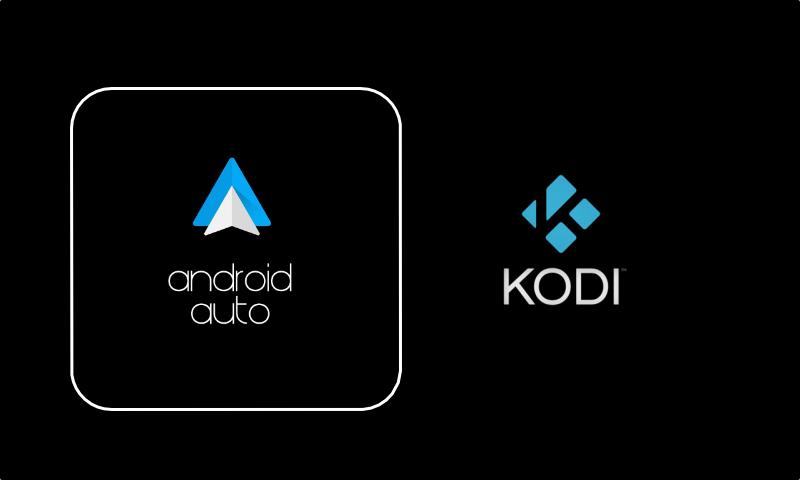

Edit: Another option is to just use the VIM and then use an RPi to add Android Auto:
No touch doing this, but also not the hardware modification of the RNS-E itself.
