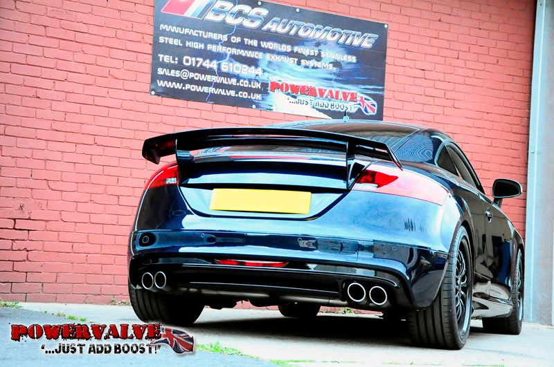

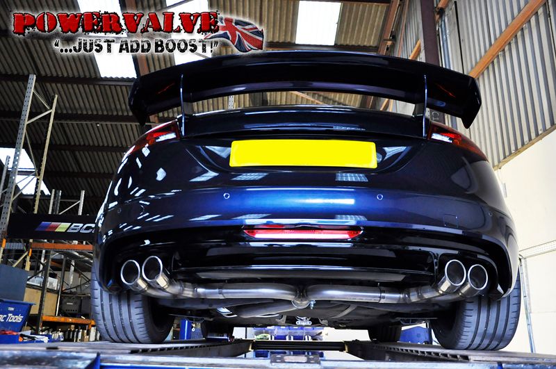

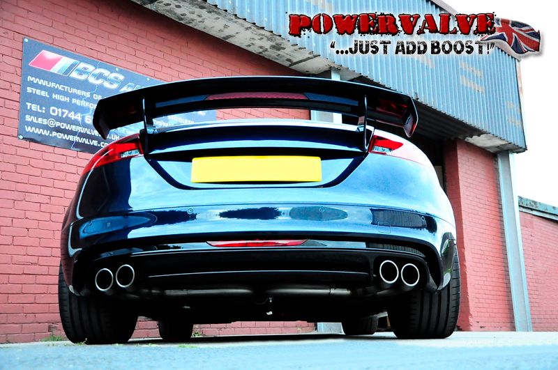

GRC84 - I have the answer for all of your troubles. I am at work at the moment and will take time to accumulate all the info.. But I have done exactly what you want to do with my Non Sline 2ltr TFSI.
Will get back to you tonight with everything I did and even with a picture!
EDIT: In the mean time, here's the photo from my work desktop that I keep lol.. When I get bored I stare at it for a while.
Okay here we go - as you can see with the picture above, my car is a non s line so I had to purchase the following Diffuser from Audi:
https://www.audi.co.uk/content/audi/own ... 071611B9AX
Part number - 8J0071611B9AX
This comes primed ready for spraying from Germany. Takes a number of weeks unless your local audi dealer has one in stock already. So if you're going for Quad exhausts, you'll need this one!
If you are going to stick with just the twin exhausts on the left, you'll need this one:
https://www.audi.co.uk/content/audi/own ... 00716119AX
Part number - 8J00716119AX
NOTE - Check the measurements of the exhaust tips you are buying because I bought the Cobra exhaust system with the 3'5" tips which are bigger than normal and I had to cut extra on my diffuser so they could fit through properly. The holes on this diffuser are designed to fit the standard TT exhaust and nothing bigger.
This is the link to the exhaust system I bought for my car encase you are interested - http://www.cobra-exhaust.co.uk/cobra-sp ... 11-6-c.asp
Hope this all helps. The sound of my system is amazing when putting your foot down.. very loud with a custom decat which I also have on. Only loud when putting foot down, when coasting or clutch down, you don't hear a thing. Start up sound on cold is beautiful. Recommend it if you're stuck for choice.
