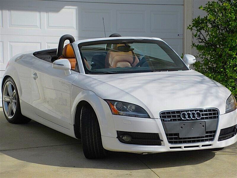

After purchasing a used 2010 Audi TT Quattro I noticed a strange thing happening to my car. Every 3 hours the theft alarm lights go off and flash for the appropriate amount of time for the theft alarm. I have the horn turned off on the control panel, but the lights flash. If I leave the car unlocked, it doesn't happen. Does it during daylight hours also. Ideas?
