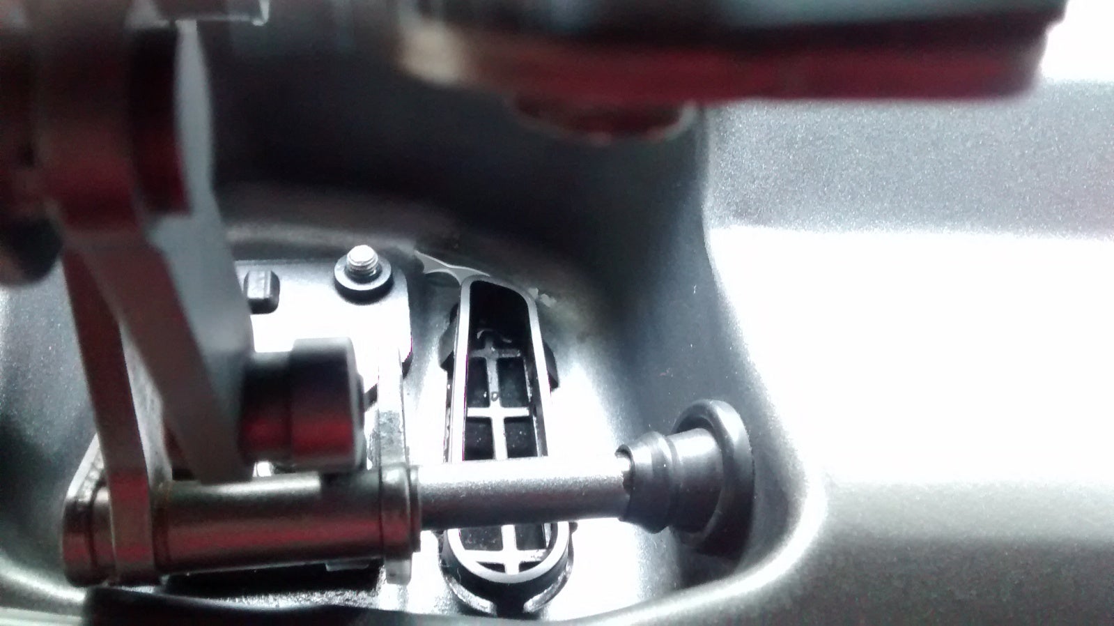

Spoiler - The two spoiler hinges should lubricated, especially in city cars that never get up to deploy speed and those who fail to raise and dry them after a car wash. Simple to do, but shouldn't be over looked -
www.ttforum.co.uk
FAQ - Audi TT Mk2 (8J) Spoiler Problems & Retrofit...
This is only posted as a FAQ since there could be several causes for the spoiler to fail. I've posted some common links on the topic in hopes to point you in the right direction to get it sorted. Spoiler failures go all the way back to 2006, so it's a fairly well known issue. Enough so that Audi...
